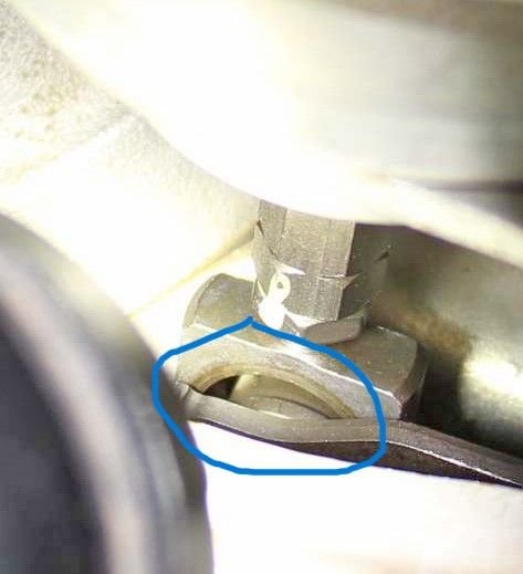

I don't know about the condition of the transmission fluid but some suggest doing a 3x change/refill first and if problems remains then change the pressure switch. I would just change the 2nd clutch one and go from there. Part number 28600-R36-004, same for 2nd and 4th from what I've read.
For the P2263 I would verify how worn the pin is before anything else. Look for a gap between the eyebolt and pin, use a good light. There are three solenoid control valves that can affect boost control, boost variable flow solenoid valve, which controls the exhaust flow direction flap and uses the eyebolt and pin linkage, the wastegate control solenoid valve that regulates max boost pressure and the by-pass control solenoid valve. There's all the associated tubing and wiring with the solenoid control valves in addition to all the intake and charged air plumbing that can affect boost control. There are so many things that can cause a slow or uncontrolled rise in boost pressure and the resulting P2263 code. I always push for live data to help with the diagnosis so you're not just replacing parts.

Even if the eye bolt has been replaced, check for a noticeable gap between the pin and eyebolt due to a worn pin.
https://cimg7.ibsrv.net/gimg/acurazi...574e734b3c.jpg
Pin and eye bolt wear areas. Pin wears in lower area.
https://cimg3.ibsrv.net/gimg/acurazi...7637f6bac0.jpg
When my car started with the P2263 code there was about a 4mm total gap between the pin and eye bolt, about 2mm of wear on both the eyebolt and pin.
https://cimg2.ibsrv.net/gimg/acurazi...7d6fa3cbc7.jpg

I've never found any spec for the actuator adjustment. As the coupling nut is screwed down on the eyebolt threads it creates a spring preload to hold the internal exhaust flap closed during low rpms by pulling up on the linkage, which increases exhaust flow velocity to spool the turbo better at the rpms. If the spring preload isn't enough I suppose the exhaust pressure could push open the flap and keep the turbo from spooling better at low rpms, which might generate the P2263. I do know when the coupling nut is screwed down to where it's covering most of the threads on the eyebolt the preload is considerable, the spring in the actuator canister provides a stout closing force for the flap, which pulls up on the linkage. If you try to press down on the eye bolt/pin linkage arm it should take a very firm pushing force to get it to move.

If you want to try something for free, you can adjust the turbo eye bolt. There is a decent chance that when you installed it, you put it in too loose.
Your RDX expects to see an instant change when the turbo is engaged. If there is any slack in the eyebolt you will get the code.
You can reach the nut that holds it in without any tools. You just have to remember to turn it the opposite way to tighten or loosen it.
Tighten it a couple of turns and see if the code goes away. It won't cost you anything and you might just "Win."

Believe it or not, there is a video for that
Since you don't want to take the ring off, you can try adjusting the LARGE/LONG nut to shorten the distance
