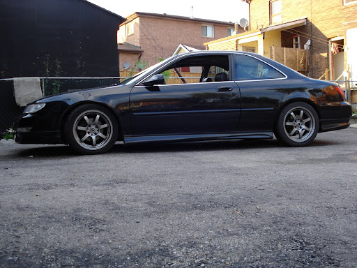

Side shot

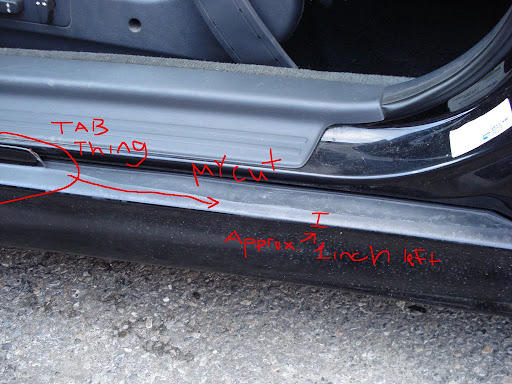

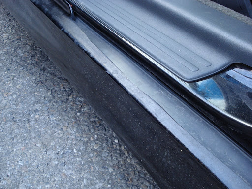

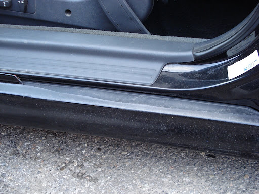

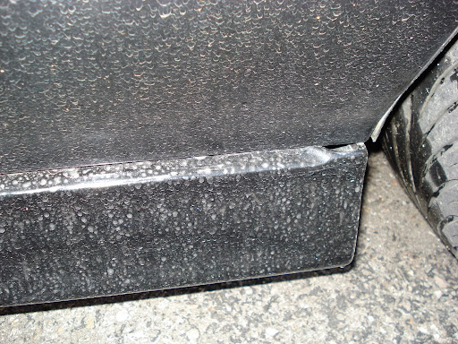

Driver side door showing what was cut - Leave about 1 inch so that the cut will not show where the side skirt meets the rear quarter panel

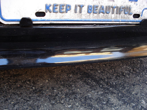

Center of the rear lip - goes right up to the license plate

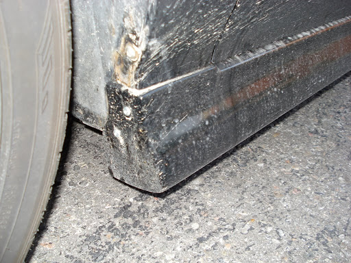

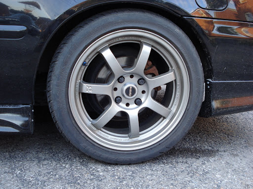

Showing how low the side skirts sit
Showing the rusty calipers off

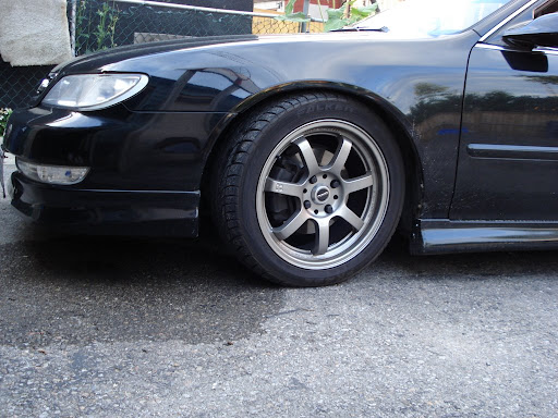

Front driver side quarter panel

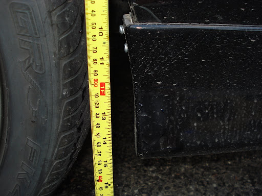

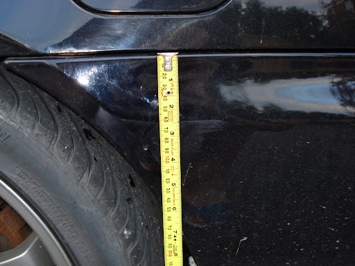

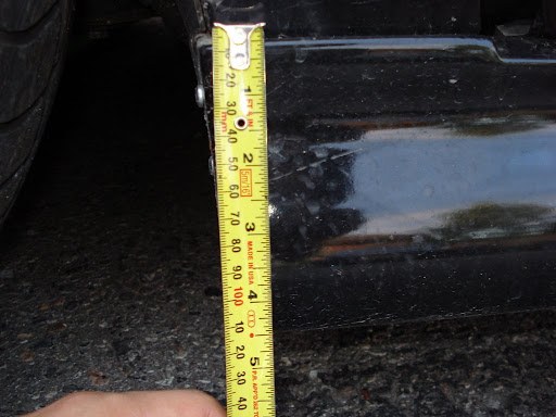

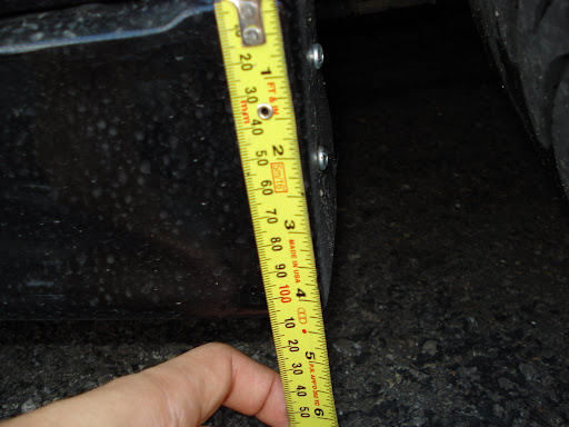

Front driver side measurement of the side skirt - about 4.5 inches
Rear driver side measurement of the side skirt - about 4.5 inches
Free handing the cut :\

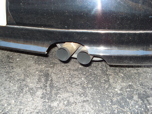

The only modification needed for the rear lip - Cut out the exhaust hole thingy
My exhaust cut out was not made for the stock CL but an after market exhaust. Temporarily just going without exhaust tips or else it'll rub.
Driver side rear bumper measurement of the rear lip

Side skirts modification
NO EXTENDING OR SHORTENING etc etc. The 4 door side skirt will have two tab thingys originally. You must cut off the rear one on each side so that they'll fit. We only need one tab, and can only use one tab. Because it was meant for a 4 door., they have 2 tabs. So we chop it off. Leave about 1 inch so that the cut won't show. I wasn't to worried about my nasty cutting skills, since it's only seen with the door open. I did it with a jigsaw. Very simple.
To install it. It's very straight forward. Couple screws etc and you're done. I didn't even tape it on. If you notice the red backing for the tape is still there. I did everything myself. So you should be able to too.

I didn't do the rear lip modding myself since I bought it off hybridnrg. But all it takes is cutting out the exhaust hole thingy and that's absolutely it. Some people just curve the lip around the exhaust (bend it up). NO CUTTING IN HALF etc etc. The trick is fitment and how high you mount it, angle etc. Don't angle the lip at 45 degrees....
Installing it takes time and patience. Make sure the center of the rear lip is almost touching the license plate and work around from that. Getting the center is most important and then the sides, if they're too long...you angle them down or up to make up for the space/gap etc.

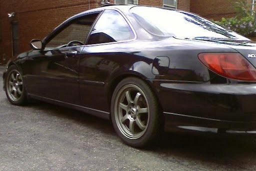

Some people say the side skirts are too low. But they really make the car looook much lower and finish the car off. It looks empty without the side skirts. But side skirts without a rear lip is silly.
With no side skirts/rear lip ...white car is Chuson from the tsx side of acurazine
No side skirts. But with rear lip. 97 CL - unpainted side skirts.

Side skirts need only 4 screws each side skirt. 2 in each wheel well. No point for more really unless you really want to secure it. I think the side skirts will rub a lot. So I want it to be able to move a bit. No tape needed really. The door keeps the side skirts in place when closed. The tape only secures it a little to make it look flush with the door open. A 1-2 cm difference.
edit - there's a spot to place more screws in on the bottom of the side skirt. But I didn't use them. You can't really jack up your car with anything other than the oem jack. I haven't tried a low profile jack, or driving over some wood to raise it etc.
The rear has 3/4inch 3m double sided tape and lots of screws. 2 in each wheel well and 4 or 5 underneath.

I dont like how the sideskirts hang down lower than the front and rear lip, and the exhaust cut out is bad lol. Looks way better than just the front lip though, i'd prefer this setup over just the front lip for your car. I like your rims too.
Old Aug 13, 2008 | 08:46 PM
gmsron's Avatar
Joined: Jan 2005
Posts: 349
From: Toronto
when it was on hybridnrg's car
I just took a bad angled shot. I just gotta bend the muffler a bit to the left and it'll be good. Eventually get around to that. Been to lazy.

Exhaust hole has been explained alreaaaady...

I think I just took poorly angled pictures. Like the first picture... the side shot is terrible. makes my car look 4x4 and doesn't represent the side skirts very well.
The exhaust cut actually looks much better than picture shows. That's probably because I didn't cut it haha. It's winter now so I've got the side skirts+rims off. I'll take pictures just to show you what it's like and how the exhaust cut looks from further back.
