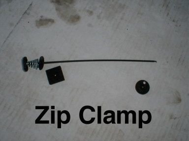

You mean the new ATF Cooler to the Condenser? Like most Aftermarket Coolers it comes with those Zip Clamps that go through the radiator and clip with a plastic retainer..
That is why you have to unbolt the condenser to make room for your hand between the Condenser and Radiator so you can clip the retainers from the Zip Clamp in place.
Here a Pic:
You push that plastic line into the radiator fins to hold the new ATF Cooler in place.. Pretty straightforward.
Also the flow is drawn in the PAINT Picture in the DIY..

Yes the atf cooler to the condenser! Thank you for sharing a pic of those clips. I was wondering what those 4 black squares on the corners were.

Yep, The squares are Soft Pads that creates a gap between the surface you are mounting and the cooler.
This is important because air flow will be restricted if you surface mount the cooler without the pads.
