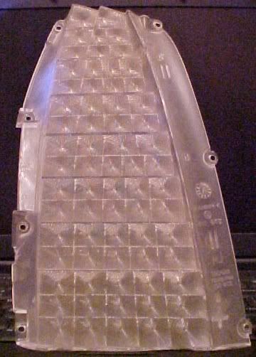

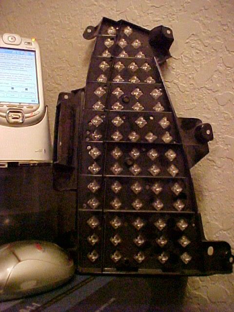

Is there a way you could put a diffuser in there? I like the uniform look of the Deville tails
Old Nov 18, 2011 | 04:36 PM
  #104
DeathMetal's Avatar
Fearless DIY Guy
Posts: 3,003
Likes: 376
From: Jersey 'Burbs
Yeah, but that'd require the entire layout be changed. Nonetheless, something like this could be used:
BUT, if you want the 'Deville' look, if you source the diffuser in a 3.5"x15" sheet, I'd make it work for you at the same cost of the standard set.
Old Nov 18, 2011 | 04:45 PM
  #105
MTEAZY's Avatar
brahs be jelly
Joined: Jun 2011
Posts: 1,836
Likes: 247
That would be great! What type of material should I be looking at?
Here more examples of the look I'm going for
- LED Parking/Brake Light Arrays: Factory bulbs are upgraded with a dual-pattern / dual-intensity RED LED array (per tail light). In parking light mode, 215 LEDs are illuminated at low brightness. When the brakes are activated, the entire array illuminates all 273 LEDs at full brightness.
- LED Signal Light Arrays: The turn signals consist of 192 high-intensity LEDs per tail light assembly.
- Reverse Light Arrays: The reverse lights are upgraded with a high-power / high-output 21 WHITE LED array (per tail light).
- Dual pattern, dual intensity design. Each tail light uses 240 LEDs during parking light mode, 320 LEDs when the brake lights are illuminated.
- Each turn signal chamber is filled with a 143 LED array.
- Reverse light bulbs are upgraded with high-output replacements.
- Factory diffuser lenses are removed and replaced with upgraded diffuser lenses offering more efficient light transmission.
