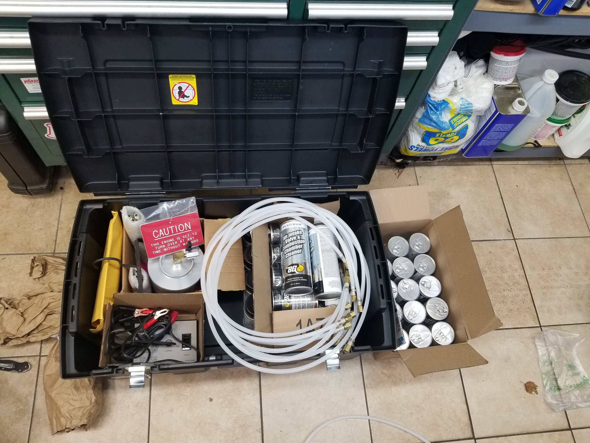

If 3k intervals were choosen since the car was new.... Probably there would be no consumption issues, but is this only my guess.
Like I said before, will be doing carbon removal procedure in a month or so. Will post few pics...
My gear is ready:
