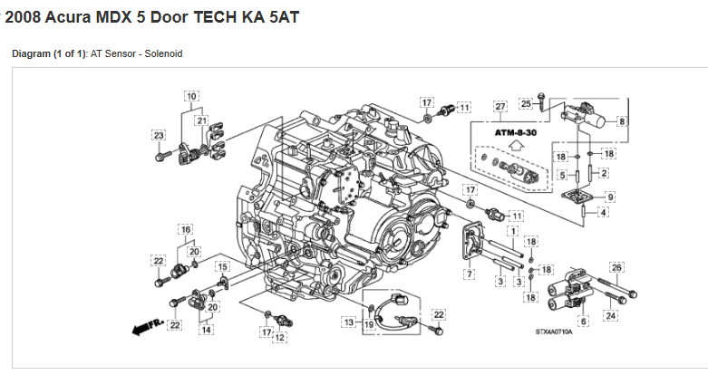

Which of the three pressure switches didn't you replace?
Contrary to what I think some originally believed, this trans doesn't have two pressure switches for 4th; the rear-upper most one is for 2nd gear.
This snip is from my '08 TL on AcuraPartsWarehouse, it looks like the '08 MDX got a similar transmission.
My guess is everything got really hot/baked when the ATF leaked out. I would guess either rebuild or replacement is in the near future
FWIW, I have hit or miss luck with RockAuto solenoids/sensors. I would try a used OEM from a junkyard before chinesium parts.
I didnt change the one in the back. the one labelled as 2nd gear. the other ones i changed were OEMs bought off amazon from a Japanese supplier (came in original Honda packing) but their colors didnt match with the ones i removed. & Yeah you are right, when ATF & radiator coolant leaked i was on a steep road, had to go a km to get to the top and it did get super hot. I towed it back. i am not sure if replacing tranny on this old car is worth it. its in very good shape and i changed entire suspension in last summer but pouring more money to replace a tranny, don't know if its worth it.

Hmmm okay, I mean, it might be worth attempting replacement of the 2nd gear pressure switch. I'm only guessing, but my intuition leads me to believe that the PCM watches/waits for line pressure to build or release from clutches before engaging the next or previous gear. Again, I'm leaning on intuition, but seems to me if the signal from that or any switch is erratic, it might cause the 3rd gear engagement to be off.
