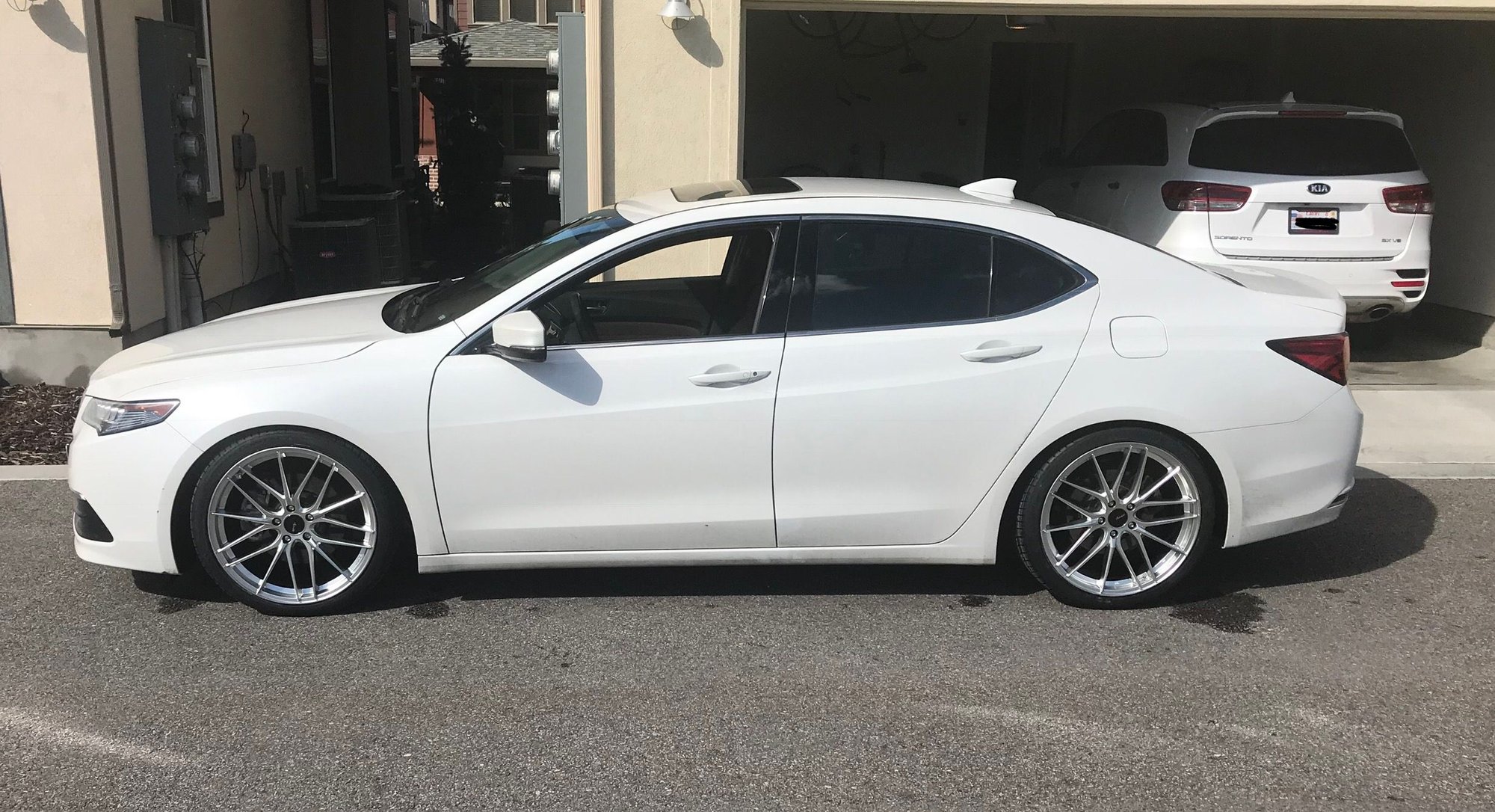

^ Are those lowered? It looks like they are to me which means a 40 or 45 profile would likely rub.
But on a stock suspension, a 245/40/20 might be okay.
If stock tire size is 225/50/18, a 245/35/20 tire is 0.4% smaller than stock while a 245/40/20 tire is 3.2% larger than stock.
Pic of car with 20's on stock suspension.
^ Owner doesn't state wheel and tire size though. 235/35/20? 245/35/20?
Car below is on 20x9 +35 wheels with 245/35/20 tires and stock height. Look at that wheel gap. 245/40/20 looks doable to me if OP doesn't run wheels with too low an offset.
